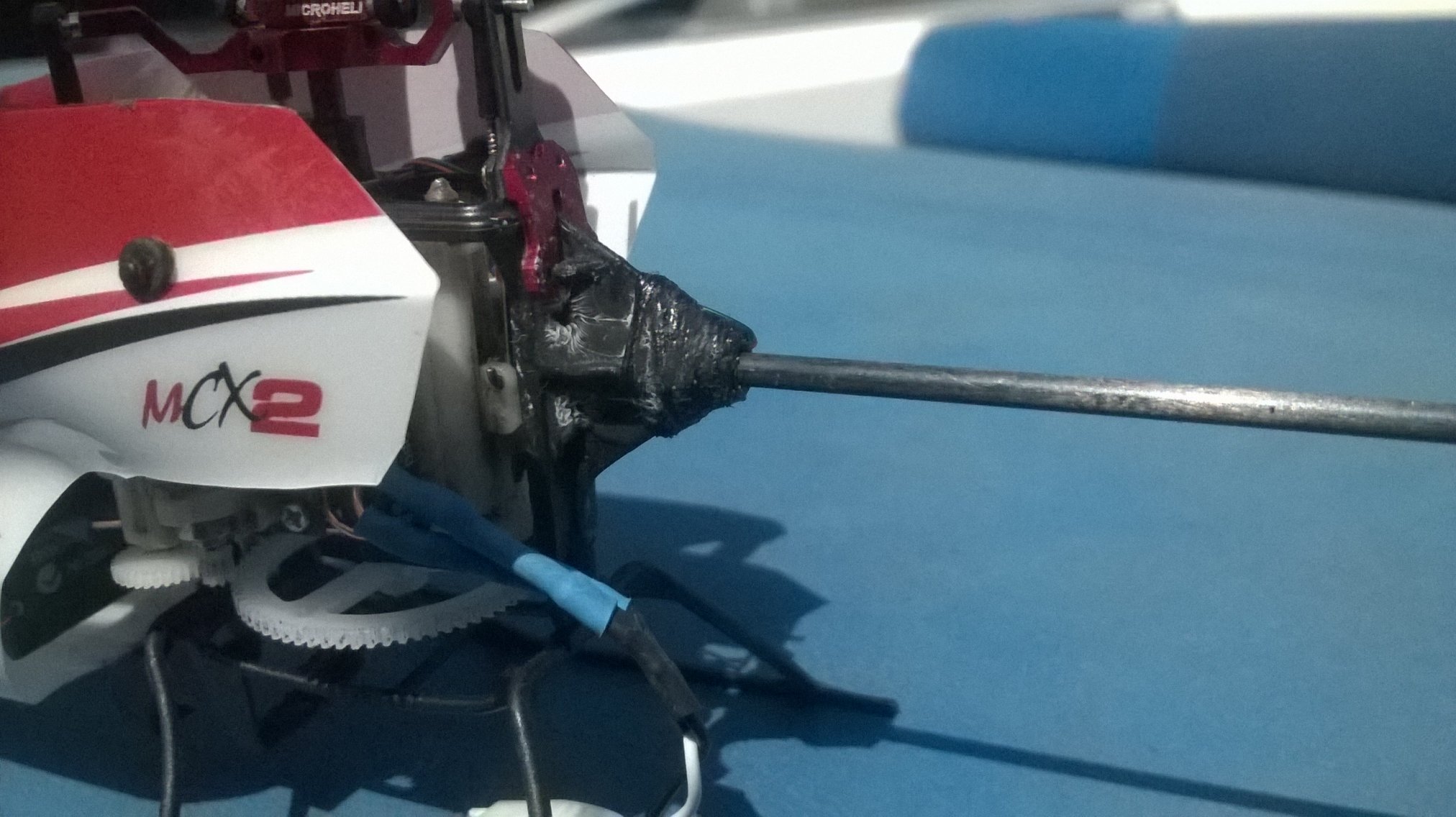

      I used to use superglue and cotton. I would wrap the cotton around the boom and frame and put superglue on each layer... just a bit. Now i would actually bring the wrap further down the boom to create a funnel type effect. It really helped - BUT, watch superglue fumes and electronics! for some reason the glue is really corrosive to the carbon tracks on the servos i found.

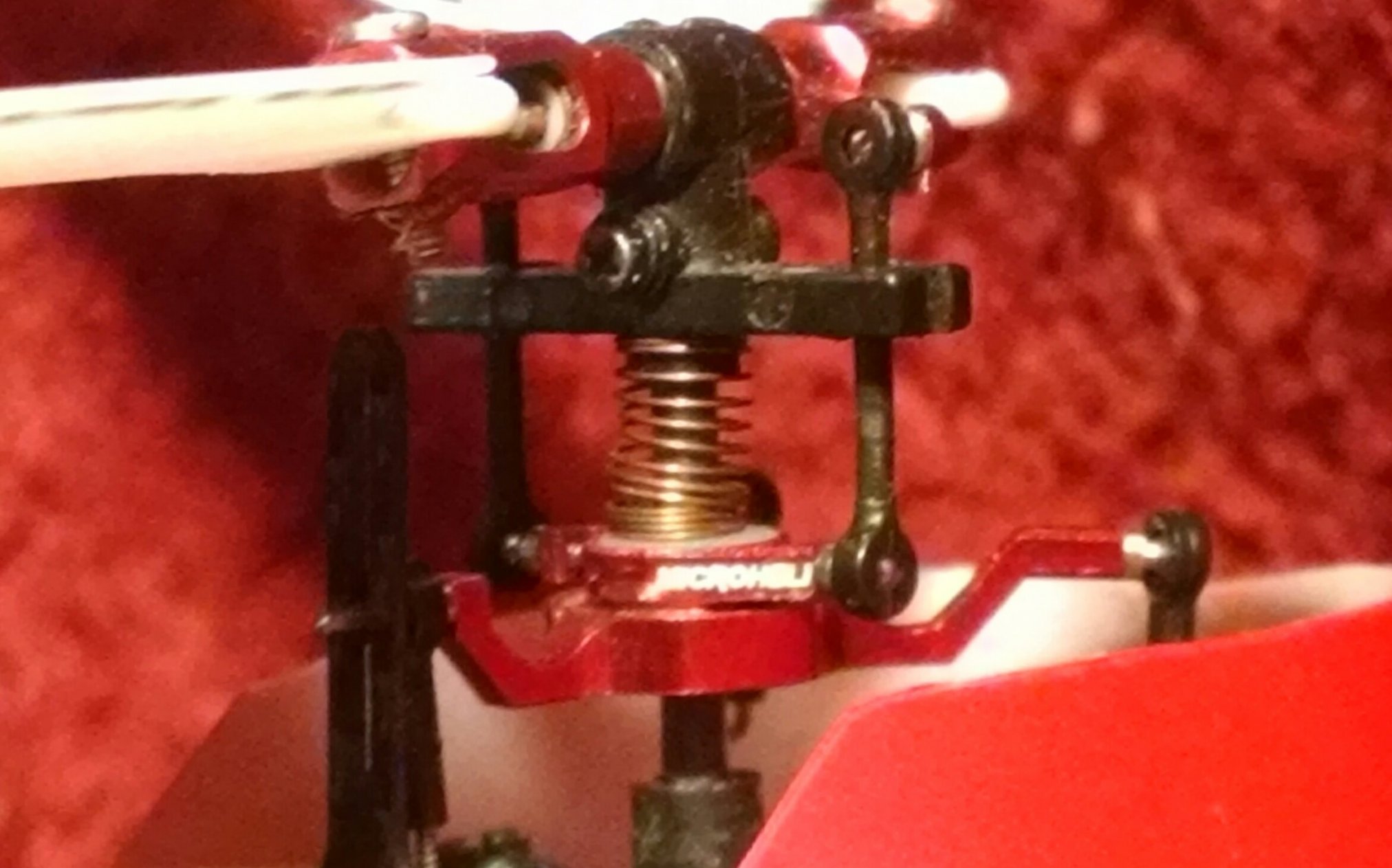

      Actually the spring idea is very ingenus and should help with the slop. The servos are the only disadvantage of the micros... but its hard to get a descent servo working on that level and still keep it light i guess... also the servos take a beating, ie they rarely strip gears...

      Right, I use a similar procedure. I've taken to wrapping and/or binding with cotton thread, then coating with superglue. Wrapping holds things tight and in place while the glue sets, then its rock solid. It's almost like using fiberglass in a way. The superglue fumes bond to the resistive coating on those servo pads. They could probably be cleaned, fortunately, I haven't run into that problem yet.

      The spring does help. I left it off when I installed the new swash, thinking I wouldn't need it. I really notice the difference when I put it back on. The Nano goes from drifting all over, to being able to spot hover within a 30cm circle with minimal cyclic input.
