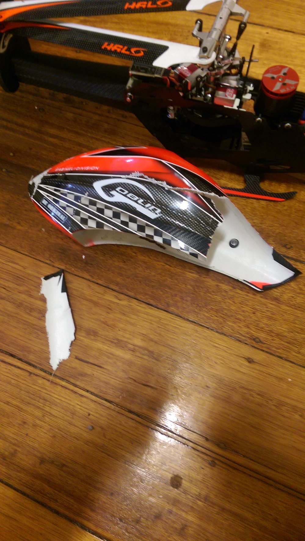

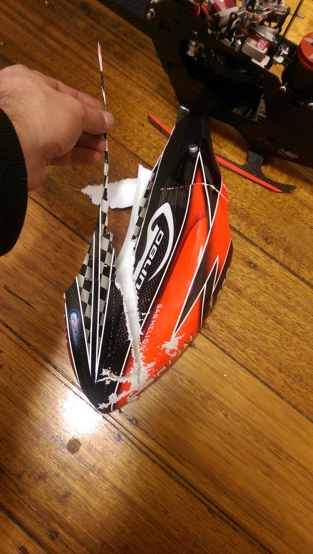

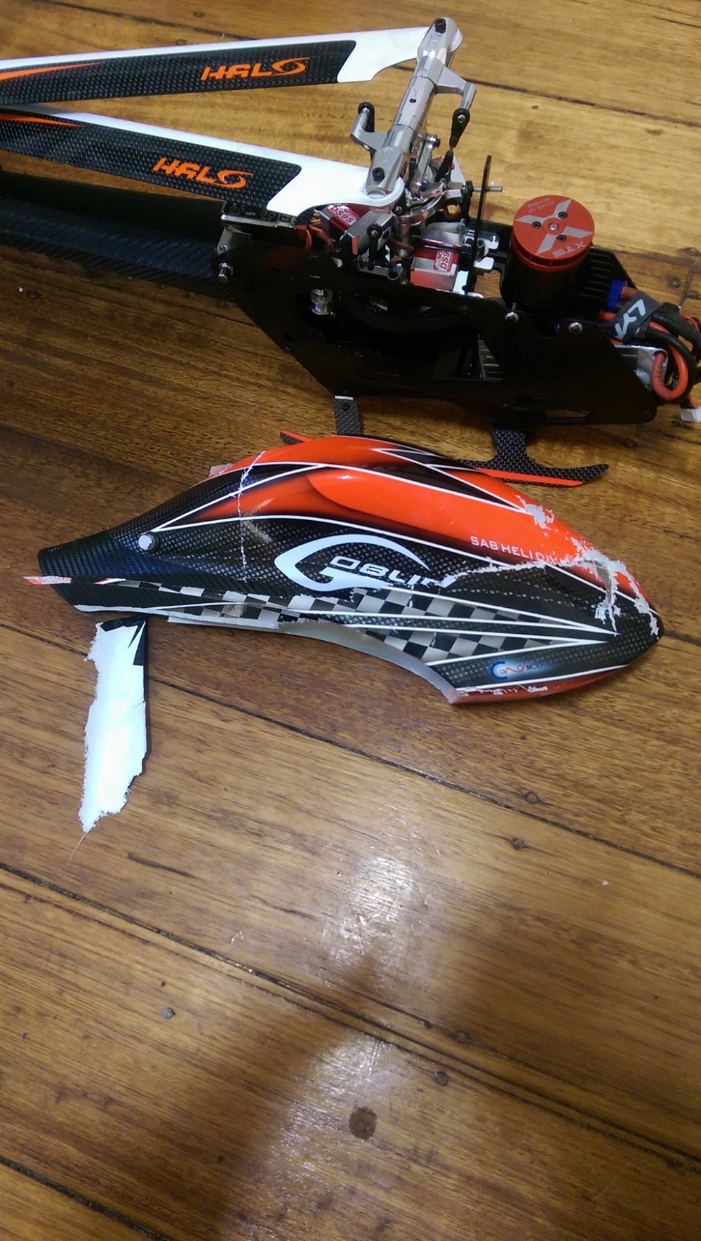

      Holy shite @The Dude that canopy looks like Crash's scythe bisected it good and proper! Did the magnetic canopy mounts let go or did you not secure them properly or was it other sinister forces at play?
    9. The Dude
      The Dude Well-Known Member
      Mar 4, 2014
      1,070
      650
      Magnetic canopy mounts... They are not very strong.. so tail down funnel into heavy wind and boom... ripped it off.. I was going to do the @3dmick Velcro mod this week... If I had done it everything would have been ok... Maybe @3dmick can post a pic for us all please...

      Hi @fred flintstones ..They are talking about putting velcro on the END of the goblin 380 canopy where the end touches the boom. Fit velcro on the inside of the canopy and on the boom tail. When you put the canopy on, lightly press the end of the canopy onto the boom. That way IF you are using magnetic canopy fasteners, the canopy is held extra tight. If you are using the standard screw in mounts this is not necessary.
